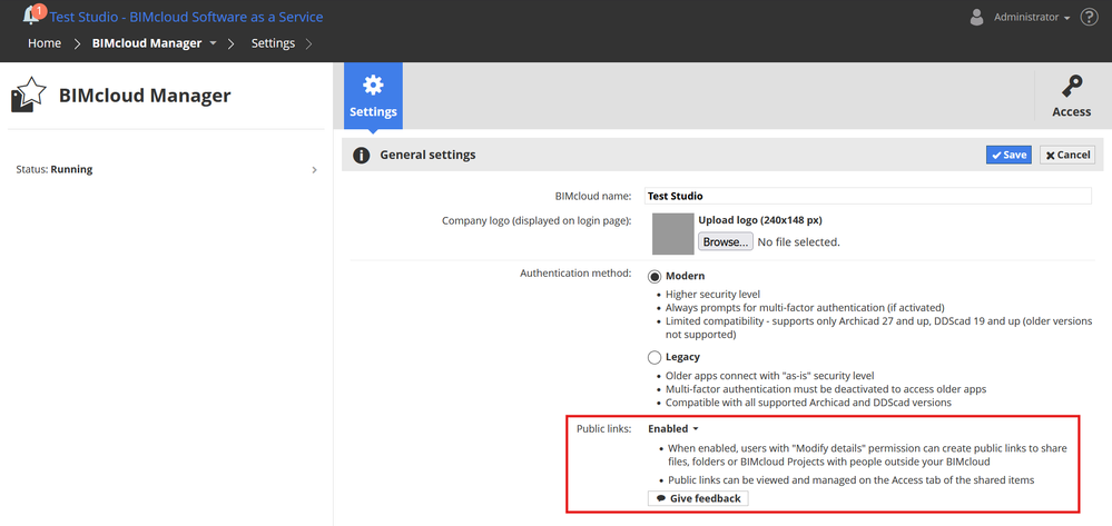

Enable public links for your BIMcloud
The public links feature is disabled by default. To allow public link sharing on your BIMcloud:
  1. Go to Servers > BIMcloud Manager > Settings panel.
  2. At General Settings, click Edit.
  3. At Public links: click Disabled and switch to Enabled.
    1. Review the public link protection settings below.
  4. Click Save to confirm your choice.
Public-link settingsPublic-link settings
After enabling public links, you can manage all public links created across BIMcloud using the Manage links button. Read about managing public links here: Manage all public links across BIMcloud
If you later disable the public links feature, all existing public links will be deleted, and people outside your organization will immediately lose access to the shared links.

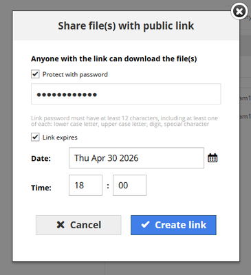

Create a public link
You can send a public link (for a file, folder, or BIMcloud Project) to an external collaborator. They can download the shared content without a BIMcloud user account. If the files are updated to a new version, those updates will be reflected on the link.
To enhance security, your BIMcloud administrator may require a password, an expiration date, or both for public links. If a password or expiration date is not required, you can still choose whether to add it when creating or editing the link.
The recipient will need to enter the set password to open the link. Once the link expires, the shared content becomes inaccessible.
Notes:
  • To create a public link, you must have the Modify details permission on the item
  • If you create a public link to a folder or BIMcloud Project, the shared content will include only the items visible to you
  1. Go to the Projects page of BIMcloud Manager.
  2. Select a single item in the Projects tree and click Create public link.
Create Public Link CommandCreate Public Link Command
Note: Public links cannot be created for Teamwork Projects and Libraries. If the public link is for a folder or BIMcloud Project that includes Teamwork Projects or Libraries, those items will not be included in the public link.
  1. Set a link password to protect your shared content. Depending on your BIMcloud configuration, setting a link password might be required.
  2. Set an expiration date and time to limit how long the public link is available. Depending on your BIMcloud configuration, setting an expiration date might be required.
Password and expiration settingsPassword and expiration settings
  1. Click Create link.
  2. The created public link URL will be shown. Click Copy to clipboard to easily share the link.
Copy public linkCopy public link

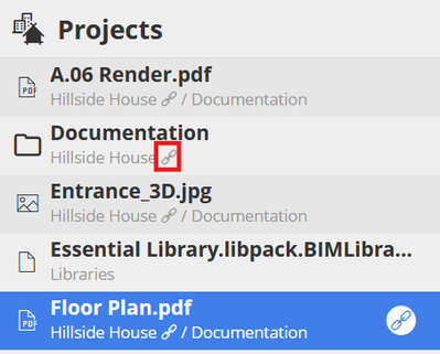

Identify shared files
In the Projects tree, items that have been shared via public link are shown with a link icon:
Shared-item icons in tree viewShared-item icons in tree view
In list view, each item also displays the path of its parent folder(s) or BIMcloud Project. Such parent items, if they have been shared, also display the link icon.
Shared-item icons in list viewShared-item icons in list view
No special permission is needed to see if an item is shared via a public link.
On a selected folder, BIMcloud Projects, or file, the “Shared with public link” text also indicates that the item has been shared via public link.

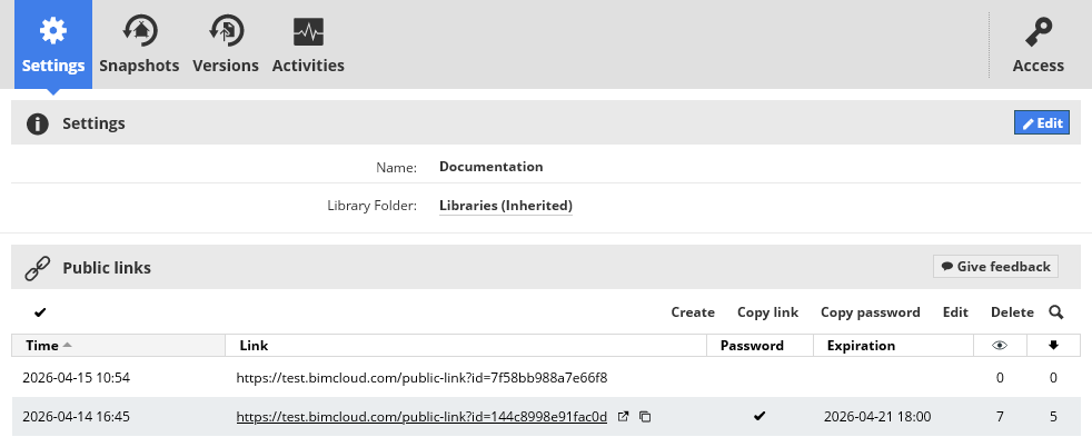

Find your previously created public links
With the item selected, go to the Settings tab and review the Public links section.
Your public linksYour public links
To select a single public link: Click anywhere in the link row
To select multiple links: Enable the checkmark icon, then check the links you need
Available functions:
  • Create: Create a new public link for the item selected in the Projects tree
  • Copy link: Copy the URL to the clipboard
  • Copy password: Copy the link password to the clipboard
  • Edit: Change the link password or expiration
  • Delete: Remove the public link - this action revokes access to third parties
Hover the link text or the password checkmark to display quick command buttons: use these commands to open the public link in a new browser tab, or copy the link URL or the password to the clipboard.
Note: You can have multiple public links for a single item - you can share an item with different people, each using a separate link and different settings. Deleting one link does not affect the other links.

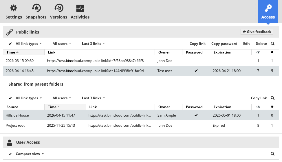

Manage public links for a selected item
On a selected item, find all public links created by any BIMcloud user on the Access tab under Public links.
Notes:
  • To see the Access tab, you need View Access permission on the selected item
  • To delete a public link or copy its password, you also need Manage Access permission
  • Viewing other users' public links requires View permission on those users
Item public linksItem public links
Public links created for the selected item appear in the top list. Public links created on parent folders appear in the list below.
The following data can be seen for each public link:
  • Source: Name and path of a shared parent folder or BIMcloud Project - click to navigate to the parent folder. (Shown in the “Shared from parent folders” list.)
  • Time: Time of public link creation
  • Link: The URL that directs to the shared content - click to test the public link in a new tab.
  • Owner: Name of BIMcloud user who created the public link
  • Password: Whether the public link is protected by a password - click to copy the link password
  • Expiration: Expiration date (if any) of the public link, or whether the link has already expired
  • Visits: Number of times the public link has been accessed
  • Downloads: Number of times a download has been started on the public link
By default, only the last 3 public links are shown. To view all links, click on Last 3 links and change it to All links.
To list the public links without a password or expiration, click All link types, then choose Links without password or Links without expiration.
You can also filter for Expired links. After a public link has expired, it is inaccessible and is deleted after 30 days. Access to already expired links can be extended by clicking the link’s row and using the Edit function.
Link-type filterLink-type filter
To filter public links by user: first change to show All links. Then click All users and select a particular user.
User filterUser filter
