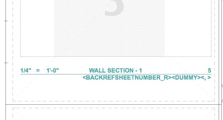

A Look at Back Reference in title of a Worksheet in Layout if it helps to answer the question

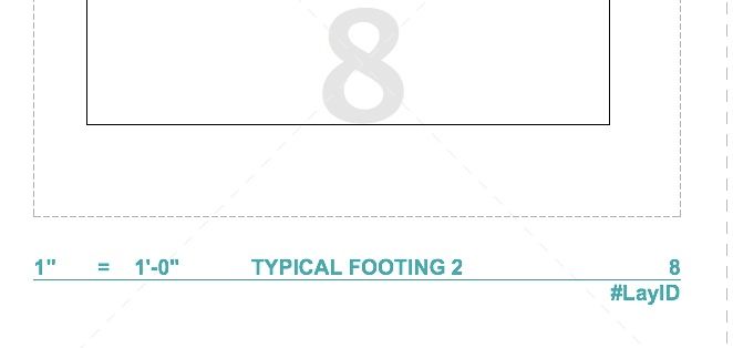

A Look at Back Reference in title of a Detail in Layout if it helps to answer the question
