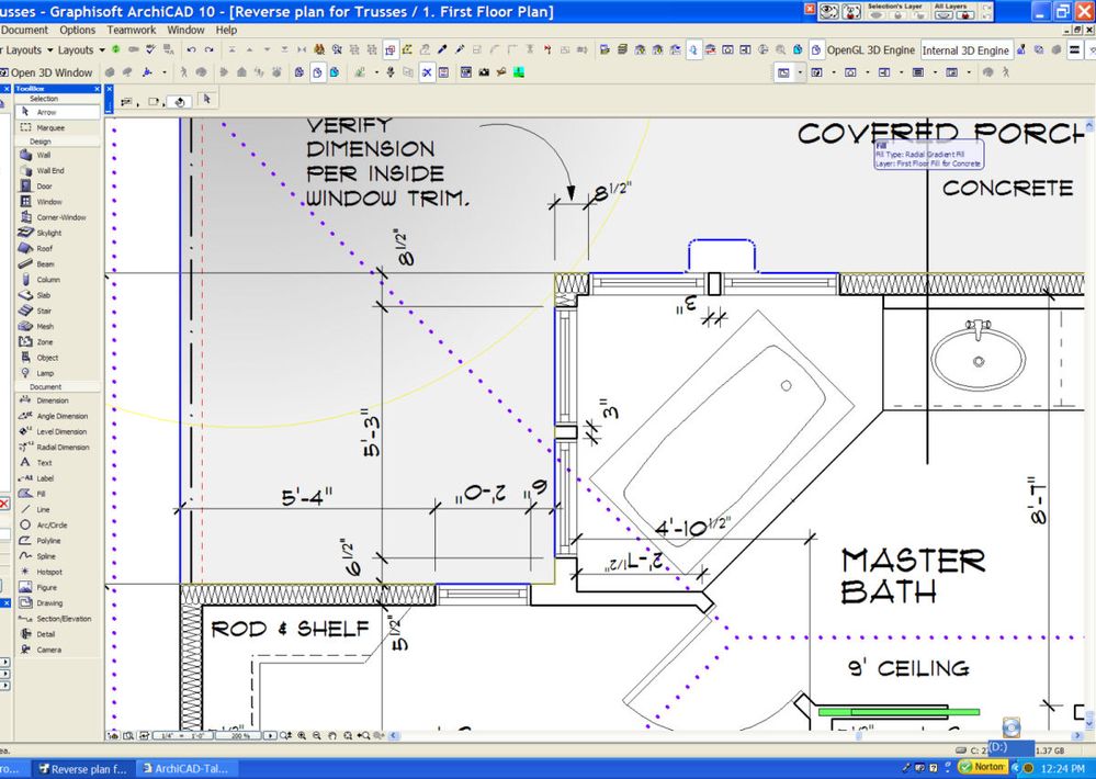

Beware of upside down dimensions.
I can't seem to get any work done because I find my self playing with the new toys. Like he gradient fill thing. I just cant seem to stop fooling with it.
One interesting thing did happen when I opened a 9 project which had dimensions that had been tweaked.
They are upside down.
Not to tough to fix, just be aware that you may need to recheck dimensions before final prints if you want to avoid some errors.
