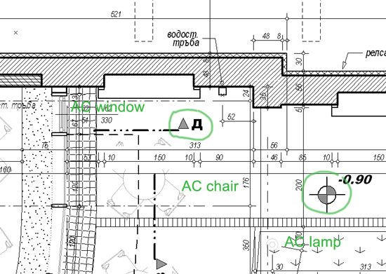

I encountered a problem with printing both with "plot" from plotmaker and "print" from 2D:
AC decides that all the solid fills should be printed as shades of gray and the contours of some Objects. I suppose it prints them as "grayscale", though I definitely select "black&white". It can be seen in plotmaker too.
In the picture everything should be black!
Anyone else with this problem?

I have tried to make the problematic pens black - no change!
All the trees are the same pen.
I seems the items, reprecented in gray are only Ac objects - windows, chairs, lamps, section makers, etc. Lines and objects with the same pen are shown differently!
