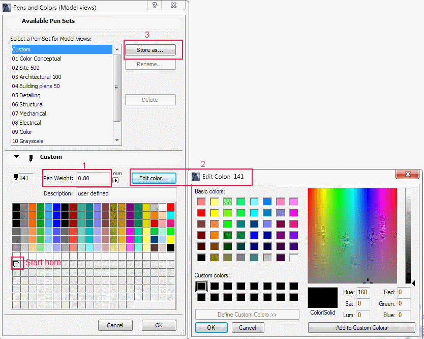

I made my first master layout, with border wich I want in 0,8mm thickness, but I cant find were can I change it. So right now my borders are in 0,13 mm... I know about this colours palate in line settings, but I don't want any colour, i want my personally made thickness! Please Help me. Thanks.

You need to select a pen for the border that is that width and color you want.

Or make your own.
Make your own, image two.
Thankyou very much
