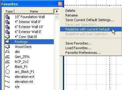

I have tried to do this as you had stated by saving the setting as a favorite but there still shows a default in the favorites. I would like to replace that with the new change in text but it doesn't allow me to over write this. Now if I change all the text that I have in the drawing and save that as a template does that default go to the new text style? The whole reason for this is that I don't want to change this everytime a drawing is started to where I have to choose the default or the company standard. I want the company standard be the default. I have a template that a retialer gave us with the demo to try out, and trying to adjust the template to match our company standards. The only thing that I need to change on it is the text default and to get this to work is that I created a favorite that has the changed setting. Ultimatly I would like to replace the default with the one I created. any help on this?
After changing the default in the settings dialogue box:
1. Click once on the favorite you want to change (Don't double click on it)
2. Move the cursor up to the little arrow to the right of "Name " heading
3. Chose "Redefine with current Default"
After fixing all the favorites to your desired defaults, from the same menu on the Favorites pallet, chose "Save Favorites" (It will save the Favorites in Demo Mode)
See attached picture.

Thanks for the info but I am unable to even find the screen that matches the screen shot you provided. How do I get to the screen that list those. The way I thought that you went thru was thru the label settings box. Am I not explaining what I am trying to do. It seems so simple with autocad I am just thinking it should be just as easy. If I can't get this figured out it would be a tuff sale to the principles
To get the Favorites window shown in the picture go to the menu; Window/Palettes Display/Show Favorites.
I think you are explaining what you want to do very well. And believe me, it's a lot simpler to do it in ArchiCAD than it is in Autocad. You need to call the reseller ( http://www.virtualcadsolutions.com ). I'm sure he will be happy to show you what you need to do.
