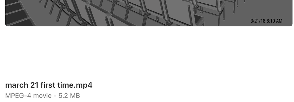

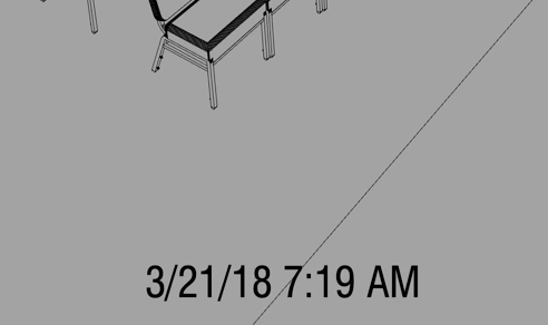

Every sun study I create outputs the same timestamp - 3/21/2018.
Only the date in the timestamp is wrong. AC is rendering the sun/shadows based on the correct date that is inputted into the "Create Sun Study" dialog box, but the timestamp in the resulting MP4 is always showing the same date.
Anyone have a solution?

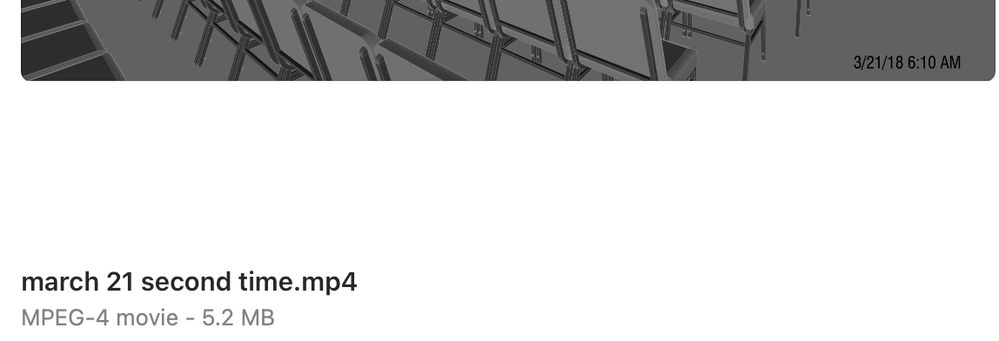

Per your instructions, I tested as follows:
I created a sun study using the default 3/21/2018.
I then created a second sun study with the exact same parameters.
Finally, I adjusted the date to 6/21/2018 and created a third sun study.
The output date is the same in all three studies: 3/21/18.
