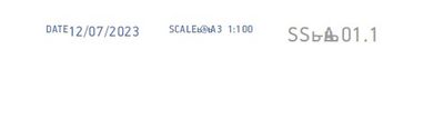

Hello,
I opened a file that was created in Archicad 23 in Archicad 26 and when I print or export the letters are unreadable.
It happens with every file I open and try to print unless I create all the text boxes and write it from scratch

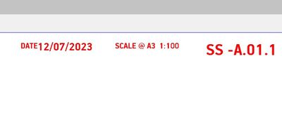

Eduardo Rolon
Known Bug in outdated AC.
Make sure you are running the latest version.
Read here:
https://community.graphisoft.com/t5/Modeling/Archicad-26-Update-4004-Preview-Antialising-BUG/m-p/357...

xdanaem
  Letters in layout and letters when i print  - is there any chance there is a solution to that ? it will take me ages to rewrite everything
Solution
Eduardo Rolon
Read here:
