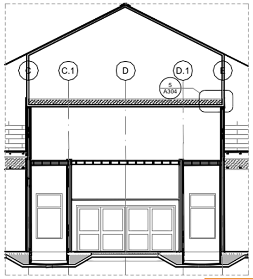

I find the Detail marker tool completely erratic and have abandoned it in favour of using multiple copies of particular views, each isolating a particular feature that I want to show at a large detail scale.
However, the if I use the marker tool in the first iteration of a view, it shows up also in the second iteration even tho I have changed the name of the second iteration (see attached). Is there a way to restrict the marker to the first iteration ?

Hello.
Just place your first iteration detail marker in a layer that will be hidden in the second iteration's (larger scale) layer combo.
