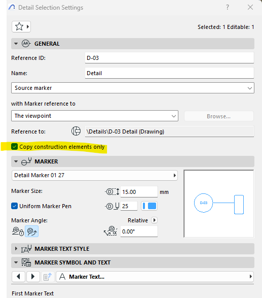

I have a detail marker which is taking a plan from the ground floor plan and displaying information at 1:20 scale. I would like to know: how to get door and window markers not to transfer from the ground floor. When I click 'rebuild from source view' the window markers always show up. I tried changing the model view options in the detail view so that the door and window markers are turned off but it seems to be showing them as shown in the ground floor plan. How can I not show these please.

At least in AC27, you have to check copy construction elements only in detail settings and rebuild afterwards.
