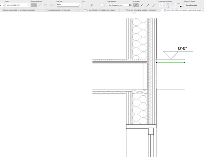

Hello,
Why drawing details, i would want all the element (or most of it) in the detail view to be of the same layer. So i select all, then select the layer on which i want to transfer all these element.  If i click on some element, say a line, i realise the line has not have changed layer... why is that so?
Thanks

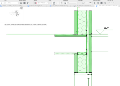

When you select all, the info box will only be showing the properties of one element (the last one selected).
In you image that is a fill.
So if you adjust any of the settings in the info box (i.e. the layer), you are only adjusting the settings for fills - not other elements also selected.
To change the layer of multiple different element types all selected at the same time, you must use the 'Edit Selection Set' command.
EDIT menu "Element Settings > Edit Selection Set.
