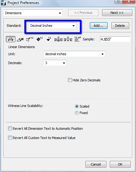

Make sure you save your desired dimension units as a Standard in the Project Preferences and assign it to the view map placed on the layout.

Thank you vistasp and Srinivas. That was a simple solution.
