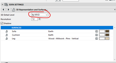

Is there a way to display objects (furniture) on a 3D document in a different level of 3D detail than in the entire model?
I would like to display the objects (furniture) for an axo in a simplified way, but only on the 3D document for the axo and not in the entire model.

This could be handled via separate model view options, one with objects set to show 3D as "Full" and another as "Simplified" or "Schematic". You can modify that setting for objects/lamps under the "Miscellaneous Settings for Library Objects" in the MVO settings, and will want to make sure that the 3D Detail level for your furniture objects is set to "By MVO" in the object settings.
