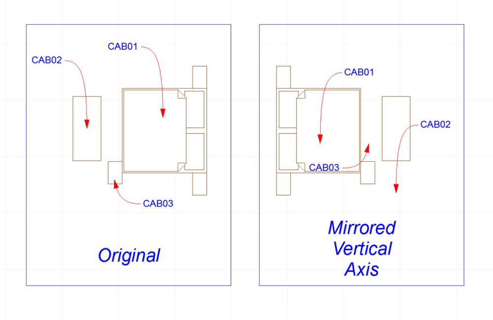

Labels may be dislocated when opening an ARCHICAD 19 project in ARCHICAD 20
Affected version: 20 | Severity: workaround applicable | ID: 201188 Due to a fix in ARCHICAD 20 which corrects the position of mirrored and associated Labels could result in incorrect Label positions when opening AC19 files in AC20. This issue may happen to associated and mirrored Labels which have been manually repositioned after Mirroring in ARCHICAD 19. In AC20 we corrected the original issue which may cause these repositioned Labels to dislocate.

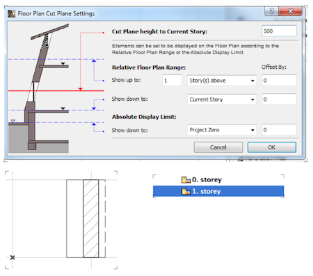

Cut plane sensitivity of dimensions
Issue
  • Dimensions relate to distinguished points of elements. In case the position and/or the geometry of the elements change, the associative dimension is naturally checked and refreshed.
  • A change in cut plane location can result in a special occasion when the dimensioned point is not alive any more. In such cases the check process might result in the loss of the associative dimension since the point associated does not exist any more.
  • This reasonable loss might cause an anomaly in the case of a plan where views with different cut plane heights are present and certain points only appear in one of the views.
  • Understandably objects that are fragile to this phenomenon are ones that have multiple different dimensionable points at different heights, curtain walls or angled walls. With straight walls the problem does not come up.
Example of loss of dimension with angled wall:
  • the dimension is picked on storey 0
  • stepping to storey 1 the cut plane height is different
  • when stepping back to storey 0 the dimension is lost
Cause
When check dimension is called, AC interprets certain elements not to be cut and thus releases the dimension attached to the cut status.
Solution
In case of the presence of such complex objects the best practice is to use the same cut plane height across the plan file.
