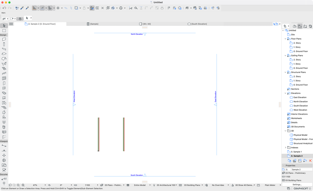

By saving Views, you can create customize and manage information like Layers, Pens sets, etc.
In my example, I manage to hide a wall by changing its Layer and the Layer Combination on View settings.
You can learn about Views and its settings on our Reference Guide
Screen Shot 2021-09-21 at 10.01.46.pngScreen Shot 2021-09-21 at 10.01.51.png
