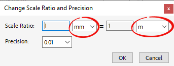

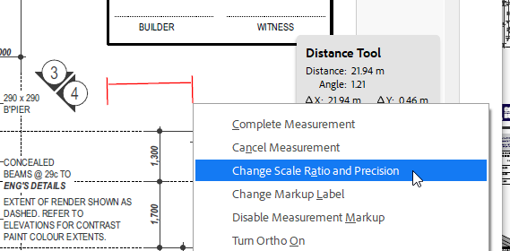

Also as you are measuring, you can right mouse click to set the 'scale ratio and precision'.
This should be mm if you set the units to mm, but you can also affect the scale here.
If it says inches here, it will measure in inches.
So maybe set this as well.

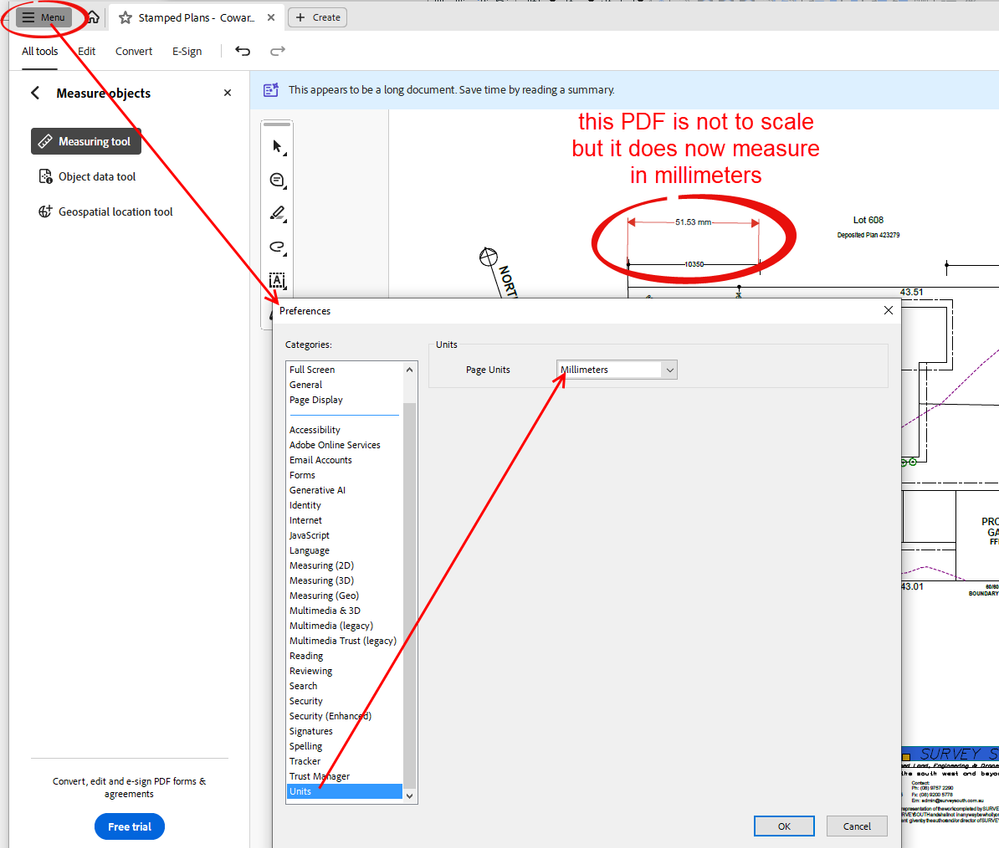

Hi Barry, thanks for your reply - o really appreciate your time! To answer your question if it's 254mm long it measures at 10 inches.
When I export my drawing as a PDF I open it in Acrobat and the default in Acrobat measure is inches. I have changed my preference in Acrobat to mm but it seems to need to do this every time I open the document, and to their frustration, so does my client. I would like to change the default of my PDF to be measured in mm and was seeing if there was a way I could embed that in the export process from Archicad?

My Acrobat was also measuring in inches.
I when into the main Menu > Preferences and set the units to millimeters.
Now it measures in mm.
I close Arcobat and opened another file and it also now measures in mm.
