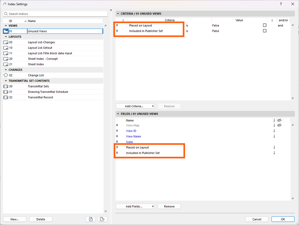

Here's how you can filter unused views in Archicad:
Go to Documentation > Project Indexes > 01 Views.
Click on Index Settings open (top-right corner of the displayed table).
Here, two new parameters can be added both as criteria and as fields to the list:
  • Placed on Layout
  • Included in Publisher Set
With the following criteria, you can find views that are not used in documentation, i.e., neither placed on a layout nor added to a Publisher Set:
  • Placed on Layout equals False – lists views that have not been placed on a layout
  • Included in Publisher Set equals False – lists views that are not included in the Publisher Set
Under Fields, all other desired parameters can then be added. The Project Index list then displays all filtered views.
Using the Select and Open Views button, you can open the desired View directly from the chart. 
