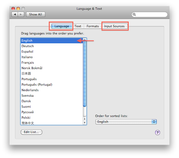

Special language characters do not appear right in texts on Mac.
Cause
A possible cause is that the language settings of your system do not match the input language you use
Solution.
In System preferences under Language & Text settings, set the desired language first in the Language tab, and also check the checkbox of the wanted language in Input Sources tab.

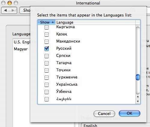

Cyrillic Font Problems

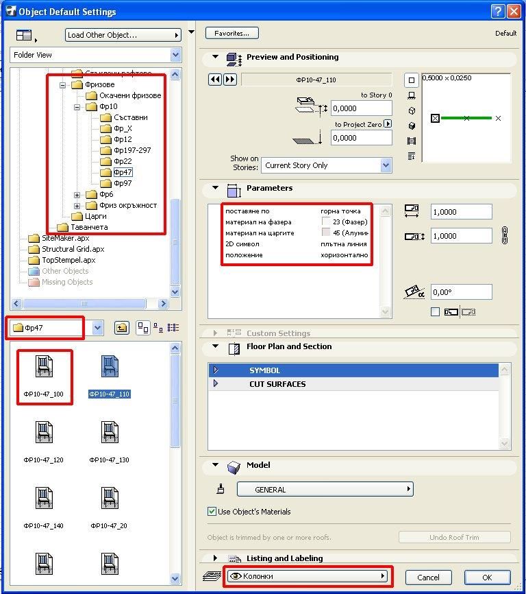

Issue
While using Cyrillic names and parameters, the text turn into unreadable characters.
wp-content_uploads_2016_06_Info_18x18.png NOTE: The Cyrillic alphabet is used by a wide variety of Slavic languages—Belarusian, Bulgarian, Macedonian, Russian, Rusyn, Serbian, and Ukrainian—as well as many other languages of the former Soviet Union, Asia and Eastern Europe.

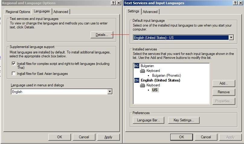

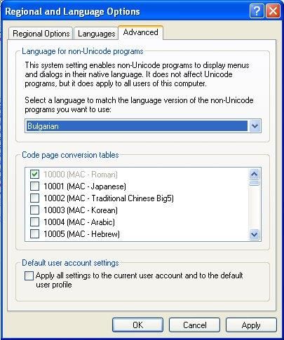

Cyrillic character settings on Windows
The "Regional and Language Options" set in the Control Panel is as follow:

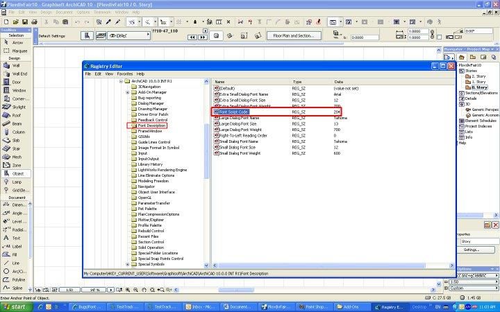

  • Access the registry, select "RUN" command in the Start menu, and type "regedit".
Then set registry key HKEY_CURRENT_USER\Software\Graphisoft\ARCHICAD\ARCHICAD 11.0.0 INT R1\Font Description\Font Script Code to 204.(Russian Character set)
After all this steps, ARCHICAD will recognize all the parameters.

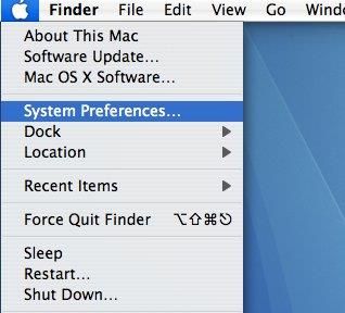

Cyrillic character settings on Mac
wp-content_uploads_2016_06_Info_18x18.png NOTE: on Mac is no registry available.
  • open the system preferences
  • select the international icon
  • edit list (select the language, for example Russian)
  • make sure, that the selected language is in the first position
After this steps restart the computer.

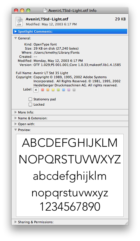

ARCHICAD 13 (which was a Carbon application) used the ATSUI Text engine, which is being phased out. Since version 14 ARCHICAD is a Cocoa application, it uses the Core Text text engine, which is used by most of the current Mac applications. Some older fonts are not fully compatible with the new text engine.
Solution
Check the Font in TextEdit, Apple's own text editor program, which also uses Core Text. If the problem comes there too, then more than likely you need to replace the font with a newer version. Get in touch with the publisher of the font.You can tell the publisher, and the published date of a Font by right-clicking the Font file, and clicking Get Info. (Font files are either in /Library/Fonts, /System/Library/Fonts or Userhome/Library/Fonts) Any font published after 2006 has a better chance to work with Core Text. It's best to use Fonts that come installed with OSX.For example a font similar to the commonly used "Mr. Hand" can be downloaded for free at this link: "Flux"This site also has a good set of free fonts.
