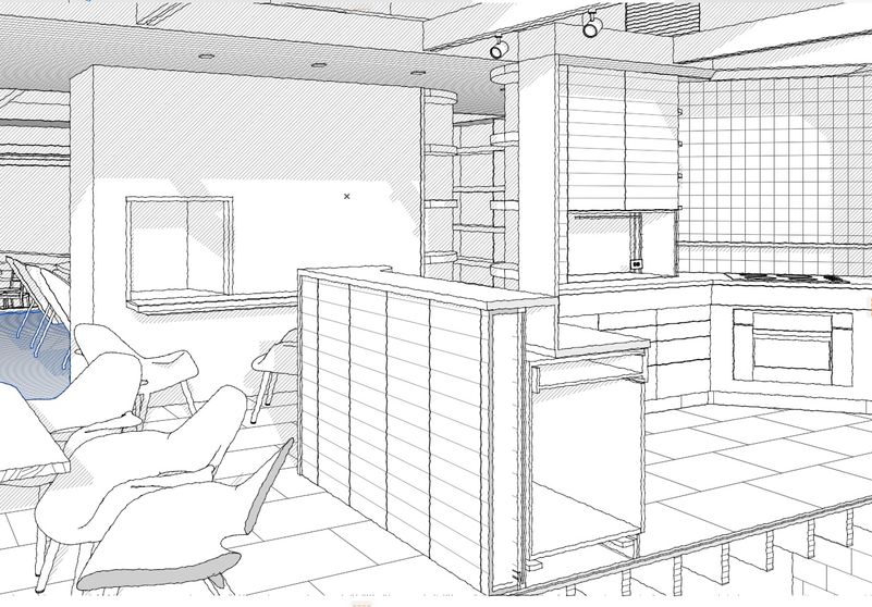

Any updates to graphic overrides so vectorial hatch line types can be modified?  Looks kinda funny to do a sketchy line for profiles, and then have rigid lines for the fills.
Operating system used: Mac Intel-based

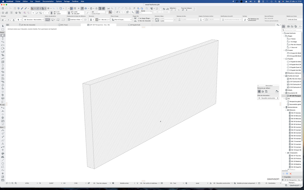

Hi nbrauer718,
Something like that ?
 Just create a symbolic fill.

In my book, "just" is a four letter word;-). As in, "we'll just move that wall". Anyway.
I've created fills.  Lots of them.  I want my model to display the vectorial hatch with straight lines in elevations, but also be able to display the hatch in a sketchy format for presentation.   Seems a shame that Graphic Overrides missed this option.
