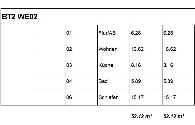

For native zones, I managed to make properties to split ID so I'd have separated apartment number and room number. I need the apartment number so I can use the headline in the schedule for that apartment and group out its rooms correctly. The problem is when I try to do that with hotlinked zones. All I got is three dashed lines in schedule.
For example, in native zones, I have an ID which is BT1.01. BT1 is ap. number and 0.1 is room number. Split property works great here.

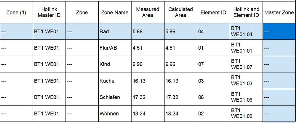

 But in hotlinked I have separated Master ID which is BT1. and Element ID which is 01. In this project that I'm working on all rooms are hotlinked but terraces are native because they are all different and I can't group apartment zones (hotlinked and native) in schedule no matter what I try.

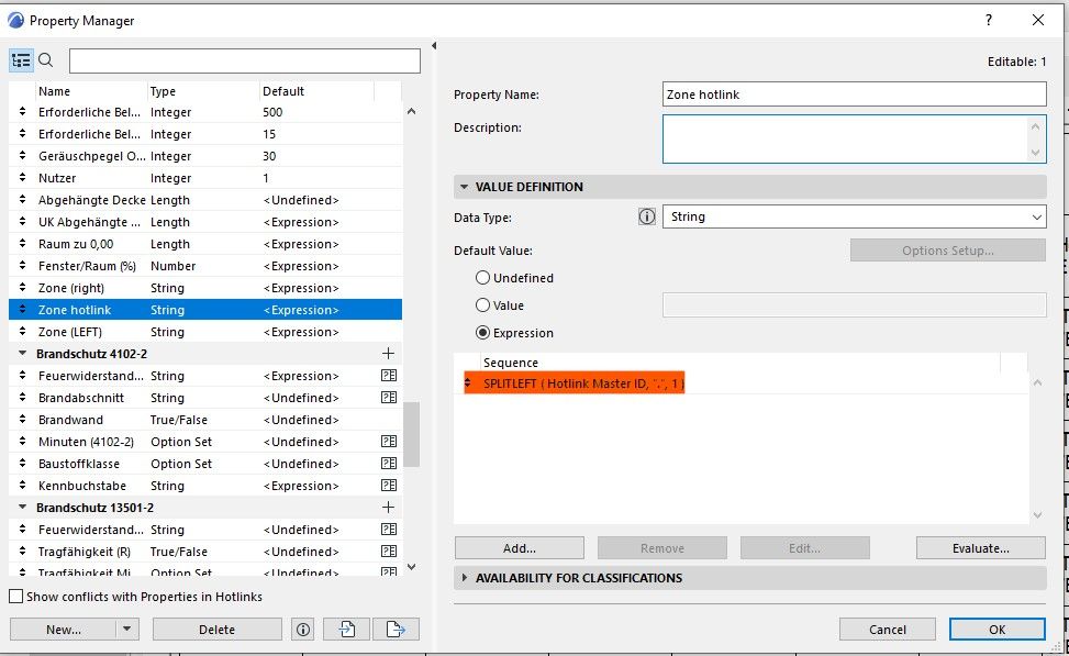

Is there an option in property to link hotlinked master ID and element ID and then use split property so I can show zones like the native one? How would you do this?
I attached how my schedule looks like. And property expression that I used. I use Archicad 24.
I'm sure you've solved it by now, but anyway... There is a Parameter in the Expressions Editor called "Hotlink and Element ID" (under General Parameters). Have you tried using that one instead of "Hotlink Master ID"?
