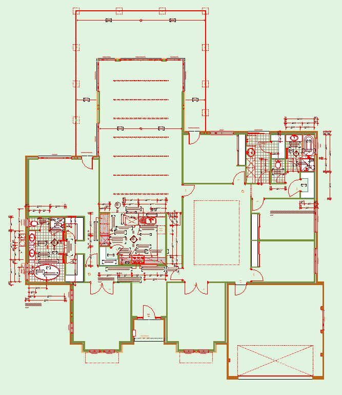

I had nothing better to do so added some images anyway.
Here is my plan with the model layers turned on and the 1:50 annotation layers as well.
I work with this layer combination but it is not what I use for documentation.
I don't worry that the text & dimensions overlap walls - just ignore that while working (you will see why later).

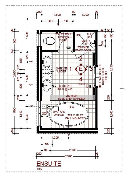

Create a new layer combination for just the model elements - no annotation layers.
And another layer combination for just the annotation - no model layers.
Save a view of each of these layer combinations and place them as drawings in your layout book.
Crop these drawings to show just the area that you need.
Because they are separate drawings they can both be cropped to different sizes.
Now overlay the two drawings and you have the room detail that you want.
And it is 100% live as it is just views of the floor plan.
All you have to do is re-crop the drawings if the size or position is altered in the plan.
Once you have set this up then everything will update automatically all the time.
