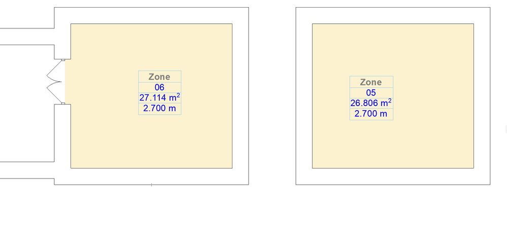

Hi, I have a problem with zone tool, the thing is it adds a door area and increases overall number which I don't want as I need only usable area rather than what I have.
The right example on image shows the correct area 26.806 for that room but left one is adding to area as you can see.
if I set zero to "Reveal to Wall Face" / a door offset,  then the room area is correct on one side (in which door is located towards the interior face) but another rooms area is getting inside anyway, how to solve that ?
In other words I need only room contour area without getting inside door passage.
And by the way who includes bottom door area into area of room, it is not correct. It shouldn't be like that by default.

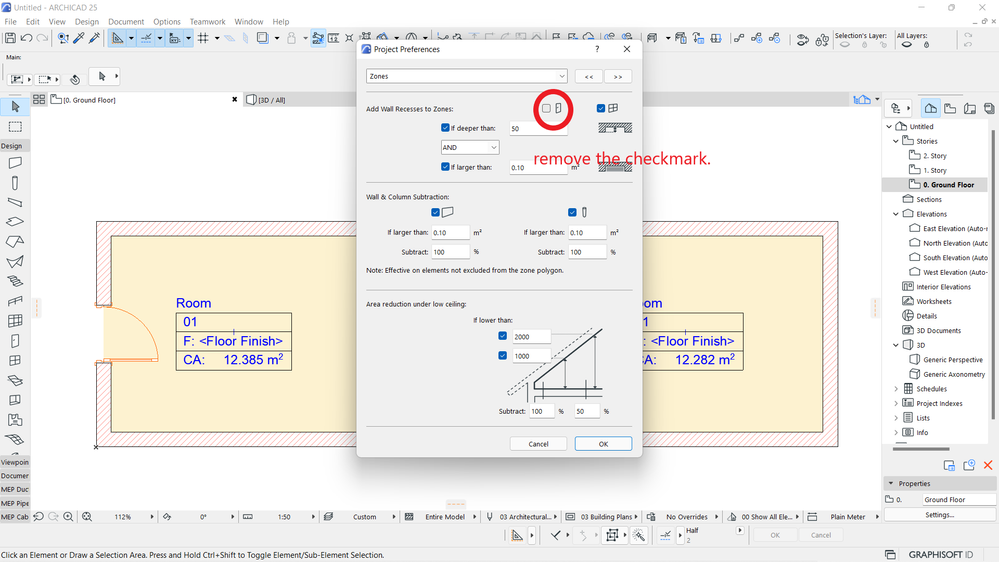

Rajesh Patil
Try the steps as shown in the attached images
then use Zone Update command from Pull down Menu > Design> Updates Zone tool to update the required zone.

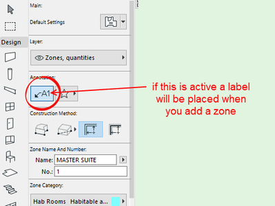

From version 25 (build 4013+) zones can now have zone labels.
So you are probably placing a zone with a label and now you have turned the zone stamp on as well (which is no longer needed).
The label can be selected and edited just like any other label.
The advantage of labels is you can have multiple labels in different layers and different positions, sizes, information, but you only need the one zone.

It helped thank you very much!

Because I couldn't customize that blue stamps(I just didn't find a way to do that) I enabled "show zone stamps" from "model view options" this one is customizable from tool option window but now I have duplicated stamps. In other words I can't get rid of that blue one at the background, any workaround on that ? Zones are heavy and complicated thing.
And why that blue one appears at all if stamps are disabled by default ?
Solution
Thanks Barry, now it works!
So previous one (which is disabled by default) will be deprecated in upcoming versions ? Why you need two same tools if that one does everything and even as you say are better.
