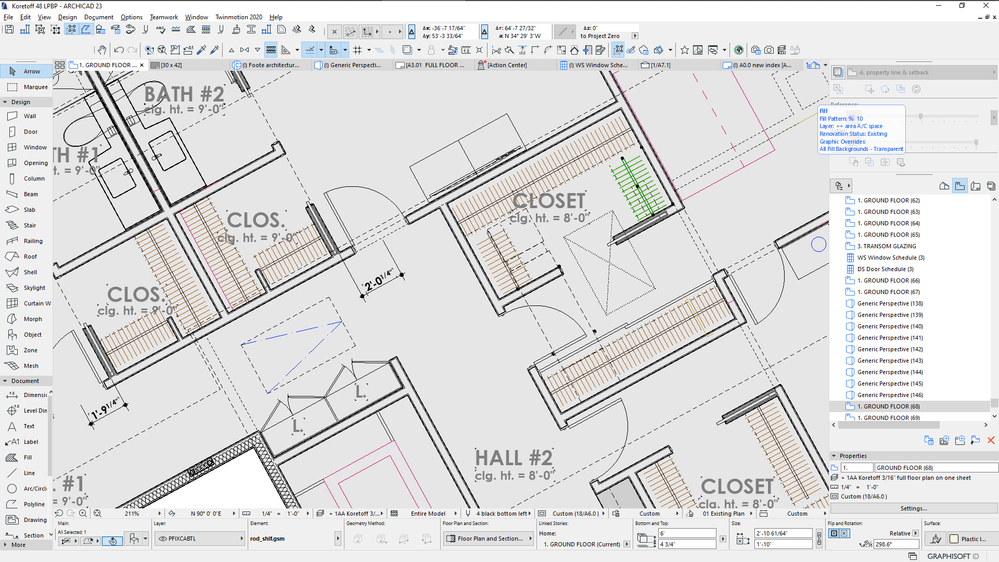

Jonathan Pelezzare
Thanks Karl,
Guess it was a 3rd party item. When I first started using it had clothes hanging in 3D. Over the years the clothes went away somehow, but it was always a good symbol in plan view and still showed the pole and shelf in 3D well enough. Bummer, because as you can see in the screen shot it worked really well in plan being parametric and all.
Best,
JP

Jonathan Pelezzare
Thanks guys for all the suggestions. Here's what I ended up doing:
Opened the project in 23 (skipped 24 all together this time I was behind 2 versions this time) selected all shelf & pole objects
in the house and grouped them sending a copy of all 750' to the right and did an explode keeping the original objects. then I those into morphs and then cut all the lines and morphs
and pasted them into the AC25. This way, I have a decent closet symbol in 2D/plan view & the sections should have a pole and shelf indicated. Not very happy with this work around especially when considering that I'll need to come up with something else when designing the next house.
Hopefully, there's a next house:-) Guess I'll have to draw the 2d symbol with lines and model the
pole and shelf (profile, slabs, etc.) Thanks again to all,
JP
