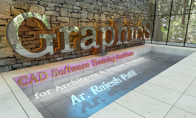

Attached one image. You can achieve such effects with self illuminating surfaces. I did this in 2018 with AC 22.
