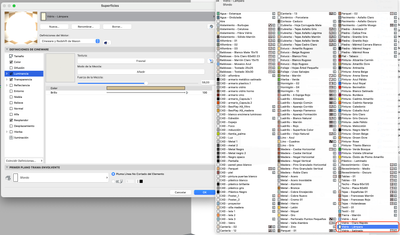

I usually use the 1x1cm beam element and the necessary length applying an emissive neon material to simulate the led strip under the kitchen furniture, it works quite well.

In the beam dialog tool you must apply a emissive material to all surfaces, in Archicad is called glass lamp or similar, but you can create your own emmisive material.
In the render options you must activate surface lighting.
