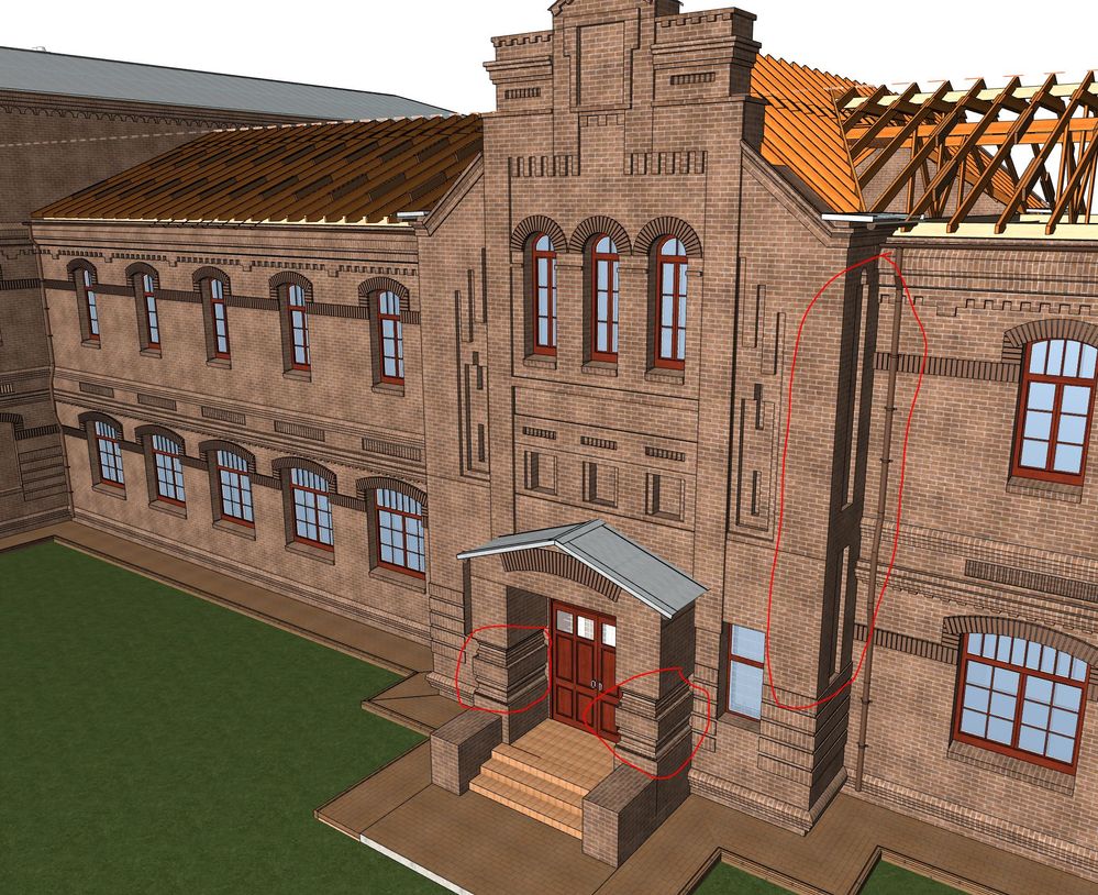

222.JPG221.JPG. All New Year 's Eve mood !!! 🙂 The question is, I made a relief on the facade by subtracting one layer at the expense of another and solid-state modeling, so, the subtractors have a priority of 2 and then I hide this layer, recesses appear on the facade, everything seems to be fine, but time passes, and again I have to click show all layers, then I hide again, but the priority of the layer is reset to one, why is this happening? and how to fix the specified parameter.
2 REPLIES 2
You have to set the layer priority number in the layer combination as well.
Just setting it for the layer is only temporary, as soon as you use an layer combination it will be reset.
