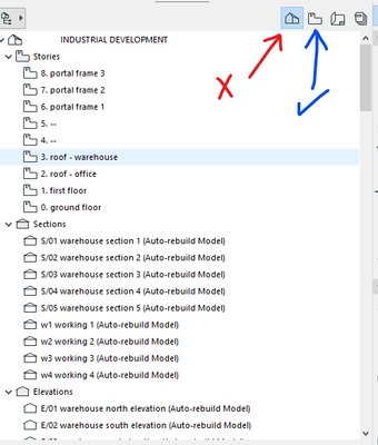

my guess is, you've right clicked on a view in the Project Map & selected "Save View & Place in Layout"
when it does, your Layer settings may have been set to Custom. ie, no layer combination selected. which means whenever you make a change (turn off/on a layer in a view) those settings won't get saved. When it does save the view (one half of the "Save View &  Place in Layout") it puts it to the bottom of the View Map folder.

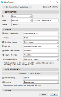

what you need to do is to save it in the View Map & ensure you've got the view settings you need for your drawing:
the screenshot above uses the Layer Combination "2100 Floor Plan DD".
if say, i turn off the Joinery Layer in the layer settings, & save the change, any view that uses "2100 Floor Plan DD" will have the Joinery Layer turned off.
if a view's Layer Combination is set to Custom, you will have to go to each & every one of the views that have the Custom Layer set, turn off/on the desired layer & update the view. This is never the desired workflow. you always want to use a set Layer Combo for a saved view. The only time i use Custom Layer combos are very specific instances & there are only 2 or 3 in each project.
