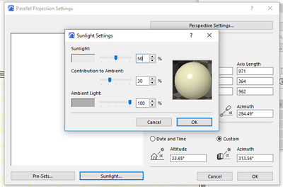

The main purpose I am modifying the Emission is so that my materials appear brighter when I save the perspectives. All the images were too dark and this is the easiest way I found to brighten it all up. Unless there is another way?

Also in your 3D perspective view, are you using the basic engine - i.e. just surface colours?
Or are you using the OpenGL (or they call it Hardware) engine - i.e. you see textures and not just plain colours?
If so then that setting has no effect with OpenGL anyway.
If you just want to brighten the 3D window, then you might want to play around with the Parallel Projection Settings > Sunlight Settings.

If your scene is dark, you could instead increase your Sunlight settings  to increase the amount of light in the scene or increase the Ambient Reflectance is your surface to increase how much of said light is reflected?

Thank you Barry, I'll try those options
