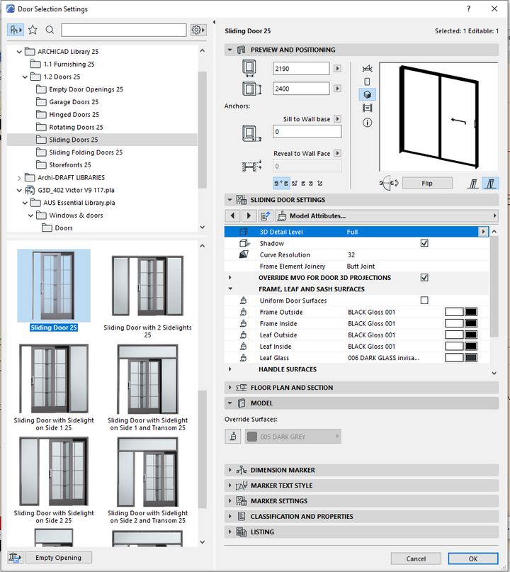

I was having some trouble using the sliding door in ArchiCAD V25. The Colour is all one colour.
Sliding Door 25 by MVO
The Rest of the Doors in the Project are fine
If I change the FRAME, LEAF & SASH SURFACES and click the box uniform surface finishes. Then it will change to whatever colour I choose; this changes the frame and the glass to the same colour, not what I need.
Question - How can I stop the colours all being the same,
Answer, - I found it as I was writing this question....
1. Open the" Door selection settings" (Ctrl + T)
2. Use the Arrow and search for "Model Attributes"
3. 3D Detail Level (This needs to be changed) from MVO to Full
4. Make sure that you have changed the FRAME, LEAF & SASH SURFACES (to whatever colours you want)
5. Hopefully this will fix this issue for you too. Happy Drafting
