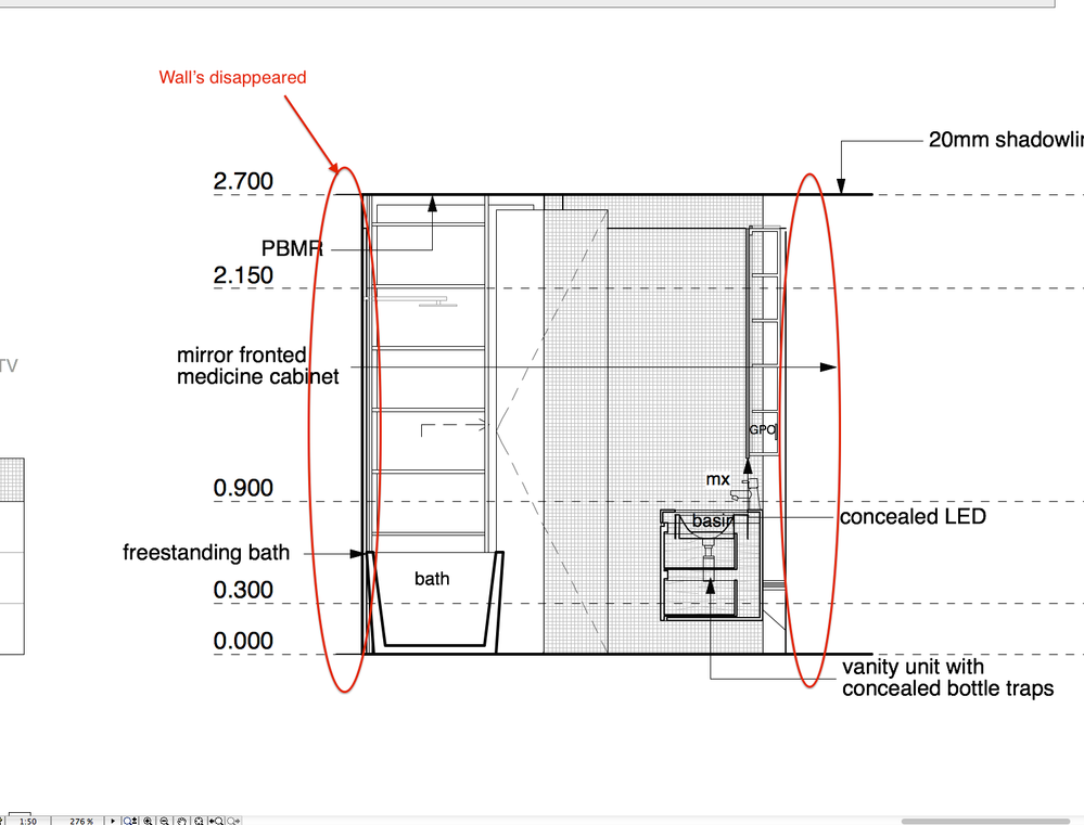

Missing walls in Interior Elevations
For some reason, in my Interior Elevations, the wall's don't show.
I have gone through the steps of checking:
1. Layer combinations in the view settings
2. Renovation Filters in the view settings and verifying the walls are on the correct filter
3. Model View options
Is there something simple missing?
or has anyone experienced this before?
Thanks

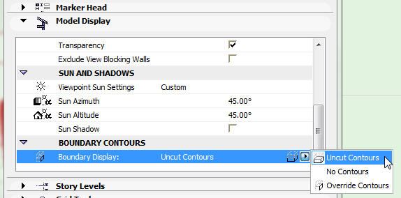

2 more things I can think it might be.
1. In the interior elevation settings look at what you have set for boundary contours (see attched image). This will show a line if you section extent is not touching a wall - set to 'no contours' if you don't want to see a line.
2. Ensure the extents of the elevations are touching the walls in plan. This should then draw a line at the edge of your elevation. If you want to see the wall thickness then stretch the elevation extents to be on the outside of the walls in plan.
