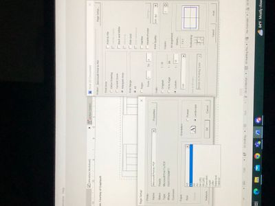

Hello,
I have a question
I’m doing my work in Archicad26 and I need to save in in scale 1:50. Whenever I try to save it in this scale it won’t fit in the paper it could fit in 4 A3 pages. I need help plz!!!
and no I can’t change the scale I need it in this scale.
thanks in advance.

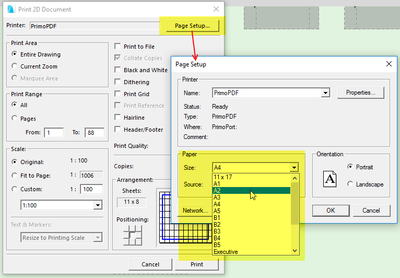

It seems that 'Microsoft Print to PDF' only has those page sizes - A3 being the largest.
You will need to install a different PDF printer if you don't have one.
Primo PDF that I shows has larger page sizes.
I am sure you can Google it.
I have no idea if it is a free PDF printer or not without checking myself.

I’m new to using Archicad how can I change the paper size, the piggest page I see when I try to print to save it in PDF is A3
If you are printing directly from the Archicad screen (I hope you are not) then just go into you 'Page Setup'.
If you are setting up Publisher Sets in the Navigator (which is what you should do), then these get the page size from the layout page you have set up to place your drawings on.
I pasted my work in a worksheet and when I try to do the page setup I only have A3-A4-A5 pages

Thank u I’ll check it out.
