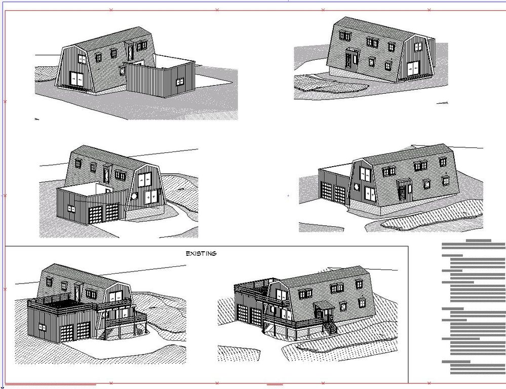

I have for some time been adding hidden line 3D internal engine. This information really helps the county plan checkers "See" the project, whether it is new construction or Remodel/Addition.
Adding these views to the layout book really increases the LBK file size as well as making the associated layout sheet PLT files around 5 MB to 6 MB. These views usually have a Mesh with a vectoral pattern as the land. This may be what is making the for the files so large. The attached image is of a current remodel that I am working on. Each added 3D view adds about 10 MB to the LBK file size.
What are others doing to present the project in 3D?
