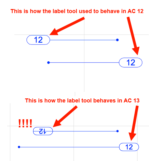

I noticed that the label tool in AC 13 has a new feature, which is the "Label Orientation" option...
Unfortunately there seems to be some kind of a problem when putting the label on the left side. The line crosses the label, and the text is flipped upside-down...
See attached image...

Looks like a GDL coding error, perhaps induced in an old part by the new feature. I haven't written/revised any labels in 13 yet so I'm not sure of the details.
Erika Epstein
Yes, it was reported. Checking and unchecking Use Symbol Arrow corrects it.
