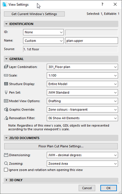

1. In the Project Map, you have full manual control of what you see on screen.
Making changes to scale, pen set, layers, graphic overrides, etc., will only affect what you see on screen.
It will not affect the views in the View Map.
The views in the View Map, have settings saved with them for all of these options.
Changing the settings in the view settings will only affect that view.
Simply changing the layers of pen set, etc., will affect what you see on screen, but will not make a permanent change to that view.
Only changing the view settings will permanently change that view.
All these vies are saved in the view in the View Map.
To permanently alter the view, you must change these to different settings here.
The idea is you can have say 3 views saved for your floor plan, and each can have different settings that are remembered for each view (different layers and scale for example).
In the Project Map, you only have one view point for the plan (or one for each storey actually), but it has no permanent settings stored with it.
This is just for working on screen and is not what you use or see on your layouts.
It is the views from the View Map that you place on layouts as drawings, so you can control the settings and know exactly what they will look like.
