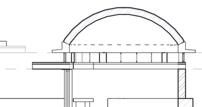

Hello,
Why are my roof front/edge/ fascia line thickness not showing the same thickness as the rest?
Thanks

Is it formed from a Complex Profile? You will need to set the outline pen of the full used to generate the complex profile to the same pen as the roof you want to match or override it in settings.
