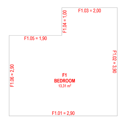

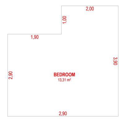

Hello,
Can you do it by writing the lengths of the sides of the zones in the correct places? That way it wouldn't matter how many sides the zone has.
It would be best if these could be listed afterwards. This way a report could be created that includes the length of the sides of the zone.
You can see what I mean in the picture.
The perfect solution would be this:
The numbering of the wall sections would always start at the same place and go counterclockwise so that the indexes could be identified. The indexing would come from the room number. This way you could make a list of the lengths of the wall sections.
Do you think this could be done using zones?
Regards:
Gábor

Hi Gabor,
Yes — this is absolutely possible in Archicad, but not with native zone stamps or labels.
I actually developed a GDL-based solution that reads the full zone polygon and places the length of each edge directly along the corresponding side — regardless of how many sides the zone has (rectangular or irregular).
The data can also be exposed for listing/scheduling, so reports per zone are possible.
At the moment this tool is still in internal use and not yet released publicly (the UI needs some refinement), but it’s on my roadmap following the zone overall dimensions tool.
Your use case description is exactly how I’ve been using it in practice.
