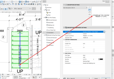

Steve Jepson
Stair display in Settings has different # of Risers
? How does this happen ?
2 Replies 2
Minh Nguyen
Graphisoft Alumni
Graphisoft Alumni
Hi Steve,
Thank you very much for the question!
I believe the text written here is for presentation only, it does not reflect the real stair's settings in the floor plan.
If I made a much longer stair, the same 10R/9G is displayed.
I hope this answers your question. Please let me know if there is anything unclear!
Best regards,
Minh
Minh Nguyen
Technical Support Engineer
GRAPHISOFT
Steve Jepson
"for presentation only" ?  There should not be any discrepancy between what is displayed in the editing window and what is shown on the Floor Plan.
