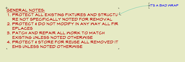

This one has been driving me crazy for a while. All my text blocks don't wrap correctly in ArchiCad 16 or in 15 either for that matter. I finally had some time and opened an old AC13 file and the text all wraps correctly. It wraps words at the space without breaking the words. In 15 & 16 it breaks the text at the box even if it splits the word. I have enclosed an image.

Or it does stuff like this...

This is probably due to a change in AC text engine form 32 to 64 bit on mac.
Please send a file and specify the name of the font so that I can look at the issue.
Thanks
