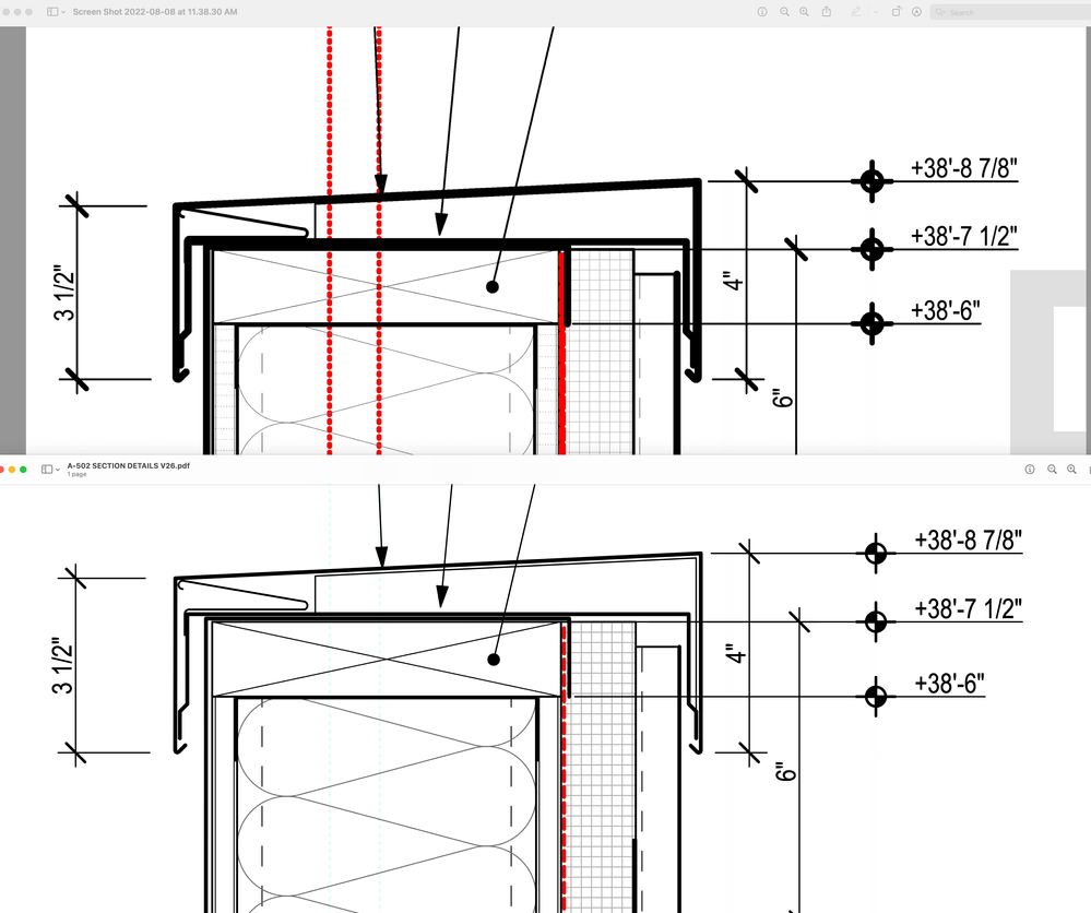

True Line Weights look too thick when 2D Drawing Antialiasing is turned off
Like the title says.
Here is a screen shot comparing display on a layout (top) versus .pdf output (bottom)
edit: Version 26, Mac

Seems pretty strange if the PDF was created from the same layout as it is shown.  They should match if all settings are the same.  The Layout looks like the wrong pen table or magnification setting is being used, as the lines are so thick that things aren't readable.  Is the PDF saved from that same layout, or is it created by a Publisher set which uses a different set of layouts (which might have different drawing magnifications and/or pen tables for the drawing)?

I'm on the Intel release (3001), MacBook Pro (16-inch, 2021) M1 Max
The PDF was created from the same layout as the screenshot.

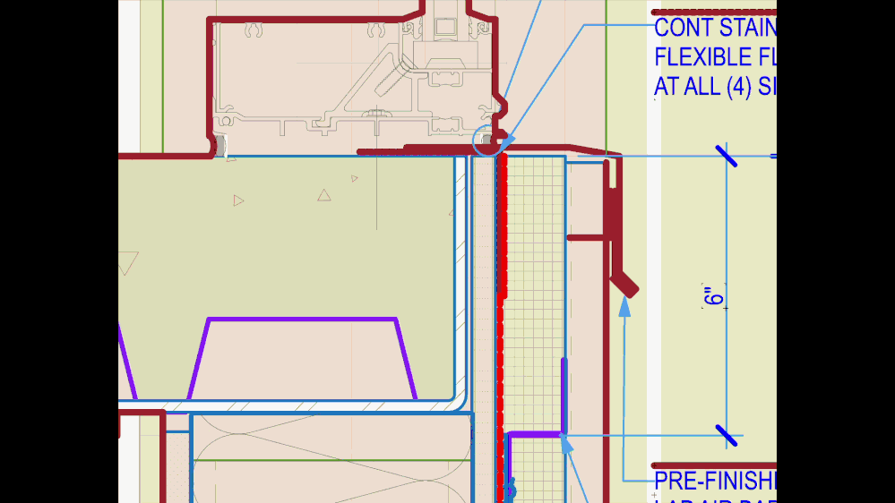

After I turned ON "2D Drawing Antialiasing" in the "Advanced Redraw Options" the preview true line weight thicknesses went back to what I would expect. See the screen recording below:

The display quality has been changed in 26.
Supposedly for the better.
I was told by GS during testing, it is advised to have 2D anti-aliasing on now by default.
My issue with this is I have it off by default, so any wall/line that is not quite horizontal or vertical shows as jagged and I know I have to fix it up.
Now they will show as smooth and I will have no idea unless I set up 2 Work Environments with it on/off and switch between them.
Or leave it off and have a display that does not look as good as it did in 25 and before.

Once I started using Retina (high PPI) displays I turned off antialiasing because I could not discern any meaningful difference off or on, and I assumed it was a performance hit to have it on.
If it's the case that it's no longer a performance hit, and turning it off breaks the true line weight functionality, it seems like the option should be removed altogether.
