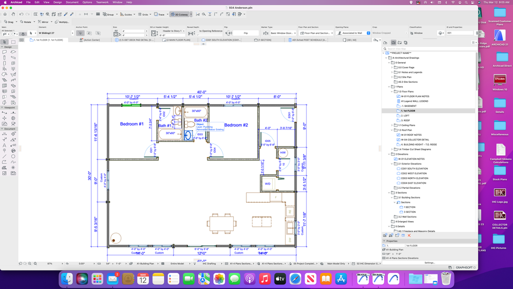

Quick Question: I'm putting in windows, but the label is set to custom and I can't change it. Does anyone have any ideas? I'm sure it's just something quick

Are you working locally or in BIMcloud?

We are using the basic window-door-skylight Marker. It shows up as "custom" on the sheet and it can't be changed to the marker
mukster
It's the basic marker attached to the window, not a separate label. It can't be changed

It looks like that marker adds the element ID as a second line.
I can't see a way to turn that of except not to add any text to the element ID.
Or use a different marker.
