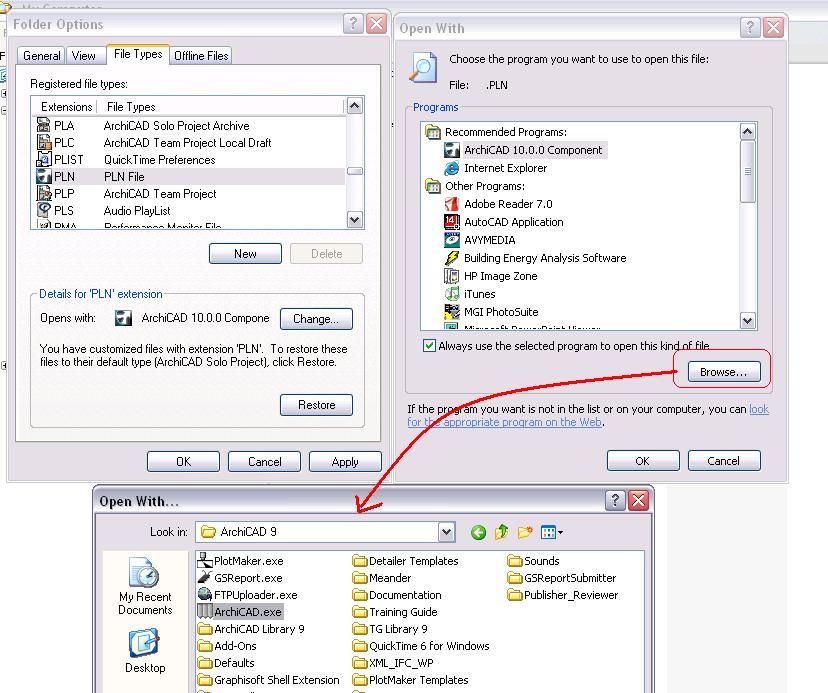

I remember attempting to do this with previous release updates AC8 to AC9, and like now I can not "see" the previous Application.
Even if I browse to to AC9 Exe file it still will not show in the Recommended or other Programs lists.
Strange. I do not know why that happens.
