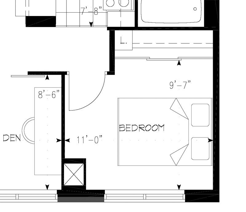

dimension style similar to this!
Is there a way to get a dimension style similar to this? (attached image)
1- The text is always horizontal even when the dimension line is vertical, and
2- Dimension text is next to one of the sides.
3- There is no witness line
I can of course move & rotate the dimension text manually one by one, but I want to see if I can automate it. this is more or less the marketing format standard here for which they have an AutoCAD Dim style defined for (hence the ugly fonts in the image!)

Thanks Stuart,
unless I'm missing something though, I think you got one out of three , my second request was to get the text to be close to the left side or right side of the dimension string (next to one of the arrows)
the white line should work fine for my needs, the only small imperfection I could anticipate is that if I have a fill (or an object with a fill) under the line, the white line will show above it, but I doubt anyone will notice and I can set the weight of the white line to the smallest possible.
Actually I think you can get 3 outta 3. (just not all in one fell swoop):
To get the text to one side use the "chain" option.
To get Text horizontal, select the dim text(s) and set to 0 degrees (not automatic but you can do an entire story at once).
To get the white line not to show over a fill, use display order.
