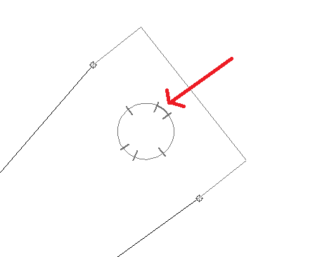

Are you sure you're placing the hammer cursor in the correct position? Notice where the highlighted (dark grey) portion of the circle is when using the dimension tool. As you move the cursor around it'll highlight different areas of the circle to indicate the orientation of the dimension lines.
