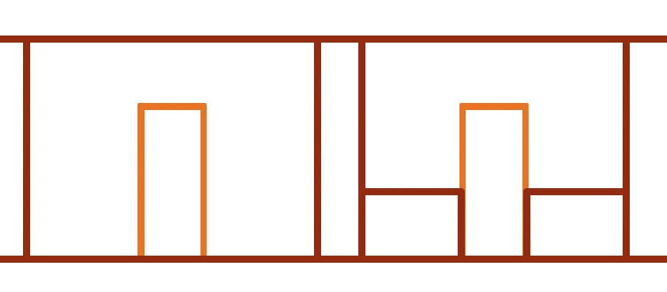

elevation of door in complex profile wall
Mats_Knutsson
Mentor
I tested putting a door in a complex profile wall and in elevation the door use the wall uncut line pen instead of the door pen. See attach. Am I doing wrong?
I'd like the door to use it's own pen regarding the outline because of pen weights.
/Mats

Play with the CP "Opening Reference" lines.
