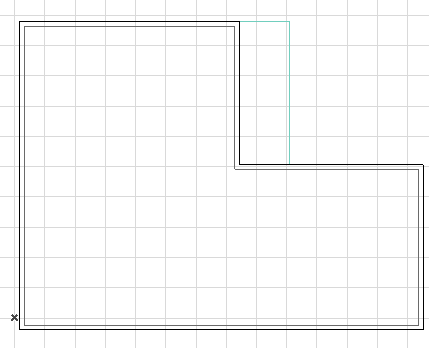

is there a way to create a structural plan view in archicad.... to make the view look upward to see the slab overhead. like if i was in G.F i want to see the slab of F.F....... thanks

i did exactly what the video said..... but i can not get the same result.... i do not know what I'm doing wrong... is there any way to help
Post a screenshot of what you achieved and point out what is not correct or does not appear the way you want it.
i create with marquee tool a 3d floor plan for the ground floor and i change the setting for the floor plan projection but the slab the G.f slab gone and first floor slab dos not appear
the first floor plan...
If you just want to show the extents of your upper floor slab on the ground floor then in the settings for the upper floor slab you will want to have a look at the "Show on Storeys" settings.
Try setting it to "show on home and one storey down".
The only control the line type (dashed, solid, etc.) is set in the OPTIONS menu > Project Preferences > Construction Elements...
You don't have any control of the pen colour (separate to what you see in the upper floor).
thank you for your replay .... the issue here is there an option to make a RCP with 3d floor plan but i cant get the sAME RESULT AS IN THE VIDEO..... THANK YOU again for your replay
Make sure that the Home Story of the Slab on the 1st Floor is the 1st Floor and not some other floor.
Also you may try to play with the Offset setting in the 3D Settings Dialog, possibly increasing it so it "looks" further upward.
