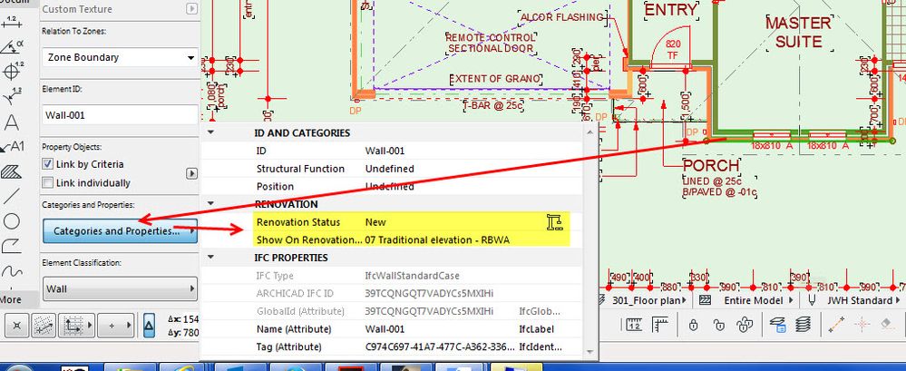

You still only have the 3 renovation status but you have always been able to create as many filters as you want.
You can then set your element to show only for that specific filter.
You actually aren't using the status.
Leave every thing as new or existing and so long as that filter you create shows new or existing (not override or hide) and your element is set to show on that new renovation filter (not 'All relevant filters') then you should be able to turn elements on/off by simply changing the filter.

Then you tag your elements to show only on one particular filter.
So now when that filter is active that element will show.
If a different filter is active it will not show.
Set up multiple views of your plans, sections, elevations, etc., - each one set to show a different filter.

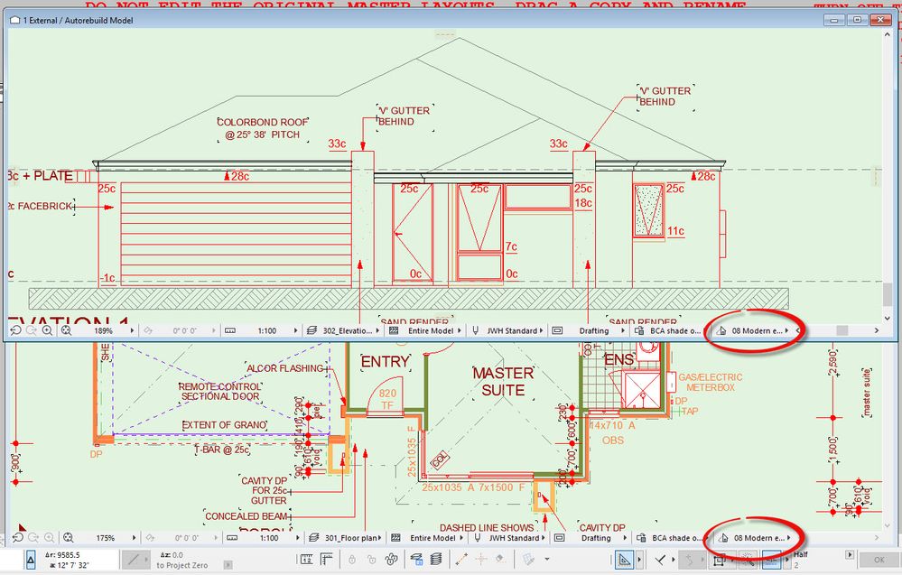

The other way we were taught of how to achieve multiple options in a single file was through the use of "spare" stories way up in space, then saving them as modules, and placing them in-situ. The modules get linked to a publisher set, so if a change is required, they are amended in their source in the spare stories, then you re-publish the module, go to the Hotlink Manager, click update etc.
Here are a couple of examples.
As you can see elements and annotation in plans and elevations can be controlled.
Option 1.
Option 2.

These also need to be tagged for each filter.
