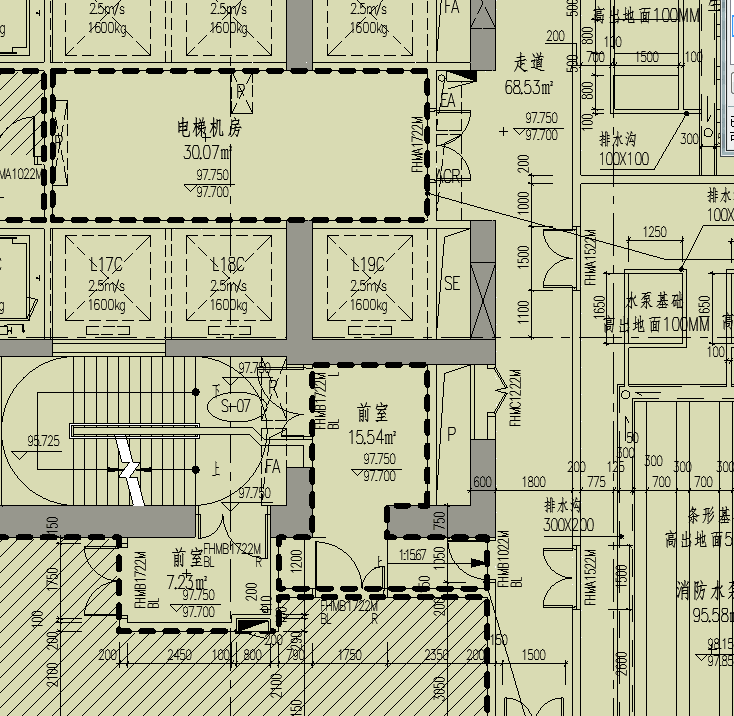

I need help.
My drawing using thick line is a little ugly. As shown in the attached image. The thick line is like sausage. How to make these thick line 's head square like in autocad, and print out nice and neat.
thank you!!

Unfortunately you can't.
Round ends and that is it.
You can use zero height walls for your lines but then you can't make them dashed without stopping and starting yourself.
I tend to set a limit for pen thickness I use for lines to 0.5mm maximum.
Just thinking you could maybe make a custom symbol line type by placing some lines close to each other (not to close).
I'm sure I have read this here somewhere before.
Be sure to use this line with a thin pen (but thick enough to blend the lines).
If too thick a pen when using this line it will still have curved ends.
