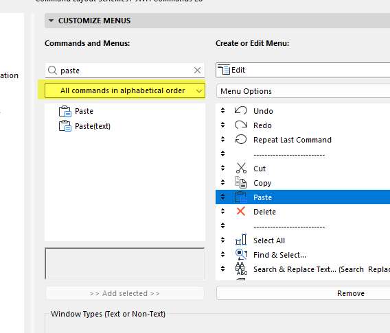

Sometimes I place elements in the floor plan to set them up, but then prefer to work on them in a different part of the floor plan window. Usually I copy and paste them back to their original location, but I sometimes I lose some details in the process (many things can get wrong lets say).
I looked into Hotlinks, but it seems way too complicated. It appears I first have to save elements as a separate file and then pull them back, which feels lengthy for small details. I also read about using groups: copy-paste to another part of the plan, edit there, and then use “Paste Special.” In Archicad 28, I don’t see a “Paste Special” option. I’m also unsure what happens if I do other work in between — do I lose the ability to paste it back correctly?
Is there another workflow or tool I could use? Hotlinks are a good idea, but for our use case they feel too cumbersome for small details.

I can't say I have ever use 'Paste Special'.
I just checked in 28 and it seems there is no such command ...

For simple things to be used on the file itself, this is fairly straightforward:
- copy paste your elements into a Workshop story (you can have a Modules Factory area with all neatly aligned with names etc., if more than one user)
- save the elements as a module into a project MODs folder, okaying to the elements on the Workshop story getting replaced by the module; you can then copypaste that module around the project as if it were an object, only it has layers etc.;
- if at any point you want to modify the module, select the module on the Workshop story and break its hotlink, modify the elements as needed, and save again as module to the same location with the same name.
On the Workshop story you may want to have some locked lines as positioning reference, because you don't want to move the elements around by mistake, or when you do you want to be able to notice and correct it.
