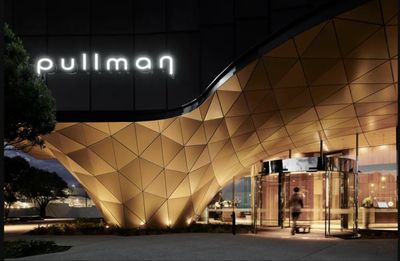

Is there a way to manually create this triangular parametric form?
 This building was modelling in Revit - but I was wondering if this triangular parametric form can be achieve in archicad? I want to create something similar but was wondering if anyone knows an efficient way to do this? I can only think of doing this through morphs
4 Replies 4
Lingwisyer
Guru
Grasshopper?
strangeday
Hi, as said by @Lingwisyer Grasshopper-Archicad is the right choice, in addition you could give a try to this object:
Responsive facade that interact with grassohopper and returns  an unique object instead of a collection of archicad native element
Francesco De Meo | Architect | AC 6.5-28 | Latest build | Win 11 Pro 64 | AMD Ryzen9 9950 | 128 Gb RAM | ZOTAC GAMING GeForce RTX 5090 32GB
cuba

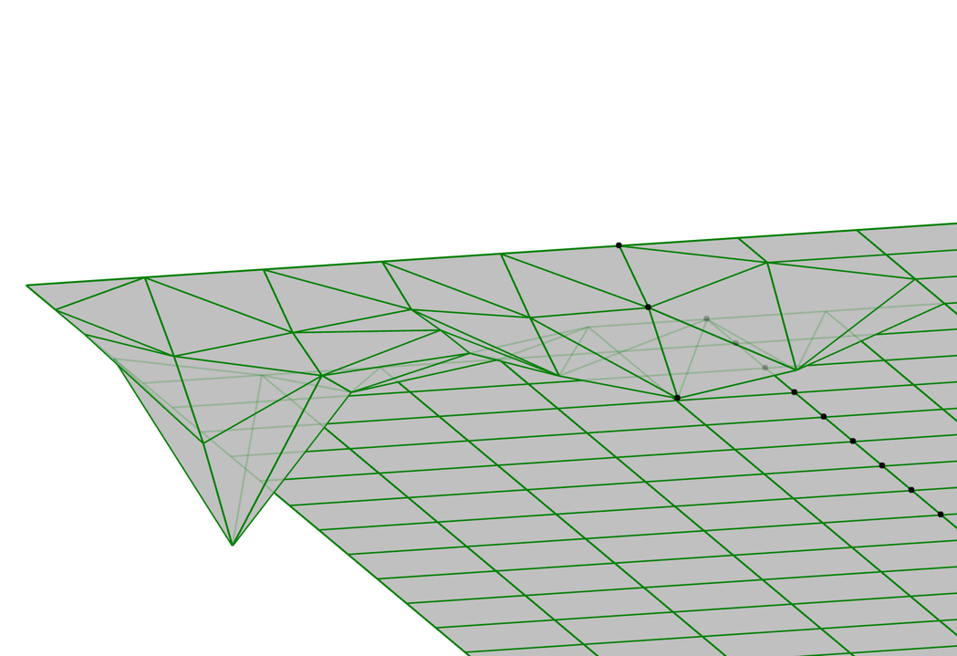

Manually >> it is just a basic mesh. Choose a grid en set all edges sharp.
With Gdl (and ai) you could make something with a little more control like level of detail and resolution etc...
Apple M1 Max 32 GB
Latest AC
jl_lt
Ace
with native Archicad tools? probably yes, but it wouldnt be fun
but still,  have a look at a guy at youtube who calls himself ArtTool, who does non conventional geometries using only archicad standard procesess
