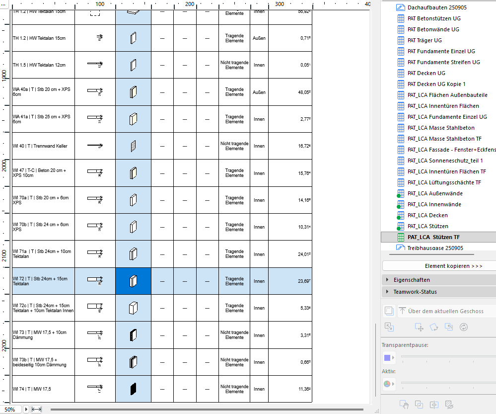

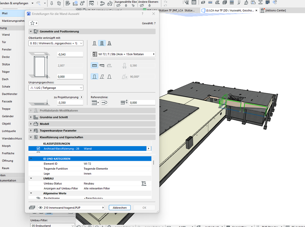

I’m really confused about what I might have done wrong — why am I seeing additional elements (like walls, etc.) in my list if I only selected columns?
Any idea what could cause this? Could it be a bug?
Screenshot 2025-10-30 112941.pngScreenshot 2025-10-30 113041.pngScreenshot 2025-10-30 113108.png

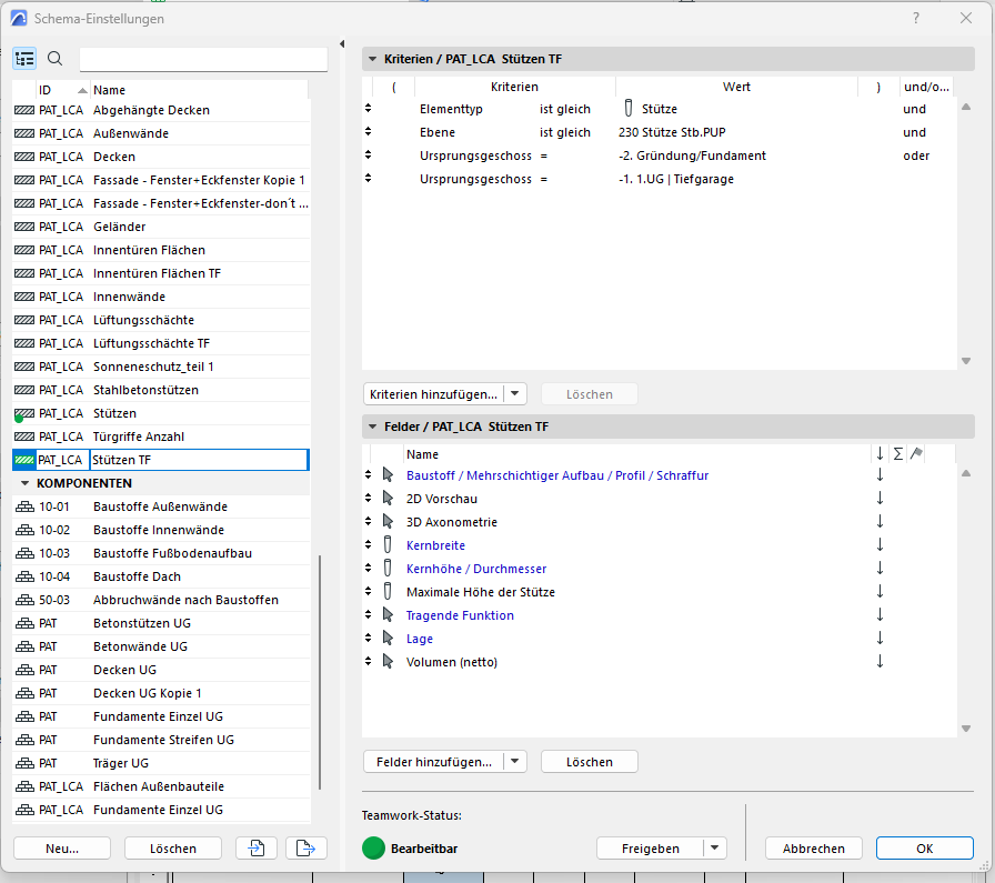

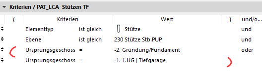

You need to put the beiden Ursprungsgeschosse in parentheses.

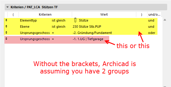

Just a golden rule: As soon you have ORs, and at least also one AND: You always need to have parentheses. Otherwise it will not do what you expect.
Exactly.
All of the walls will be in the '-1' storey, which is why they are showing.
